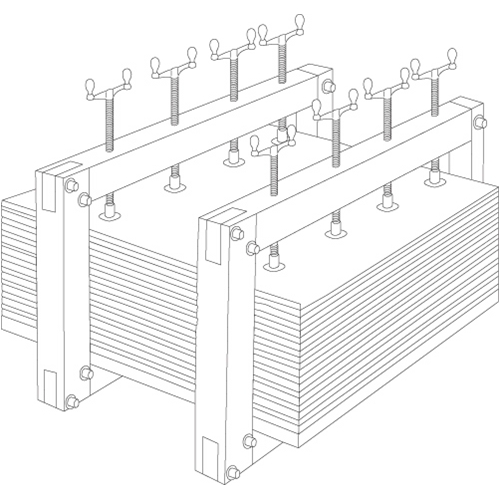

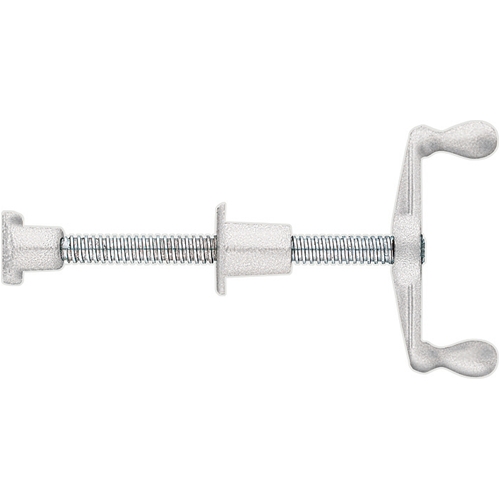

OT, but related, anyone used anything like these for 'non-vacuum' veneering?
Or, tried using a Fox style bending rig to veneer sides?
CrowDuck

PostPosted: Mon Apr 17, 2006 7:54 am
John Hall used to sell something similar to that except it had a plate that presses down and one large screw. I have used it for small veneer jobs and it works fine.
I don't know if he still makes them or not. I haven't seen him offer one in years.

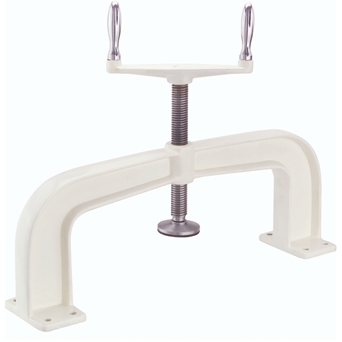

PostPosted: Mon Apr 17, 2006 7:59 am
Posts: 409
Brock,
Here's what you're talking about, from Grizzly, I think it's about $56.
CrowDuck

PostPosted: Mon Apr 17, 2006 9:13 am
Not exactly but it is similar.

Chris, I once built a press like the one in your lower picture. I bolted sustantial pieces of angle iron to the cross members to beef them up but still had the screws going through the wood peices rather than the steel. Hey, I'm a woodworker, not a metalworker. Over time, the hard maple cross members broke despite the reinforcement. Were I to do it again, I'd take the time to build the frame out of heavy steel. Those veneer proess screws exert a lot of force. I'm pretty sure the press in your drawing wouldn't last too long.
Vacuum bagging is so much easier. Not to be overlooked in a small shop is the fact that you can roll the bag up when not in use.
